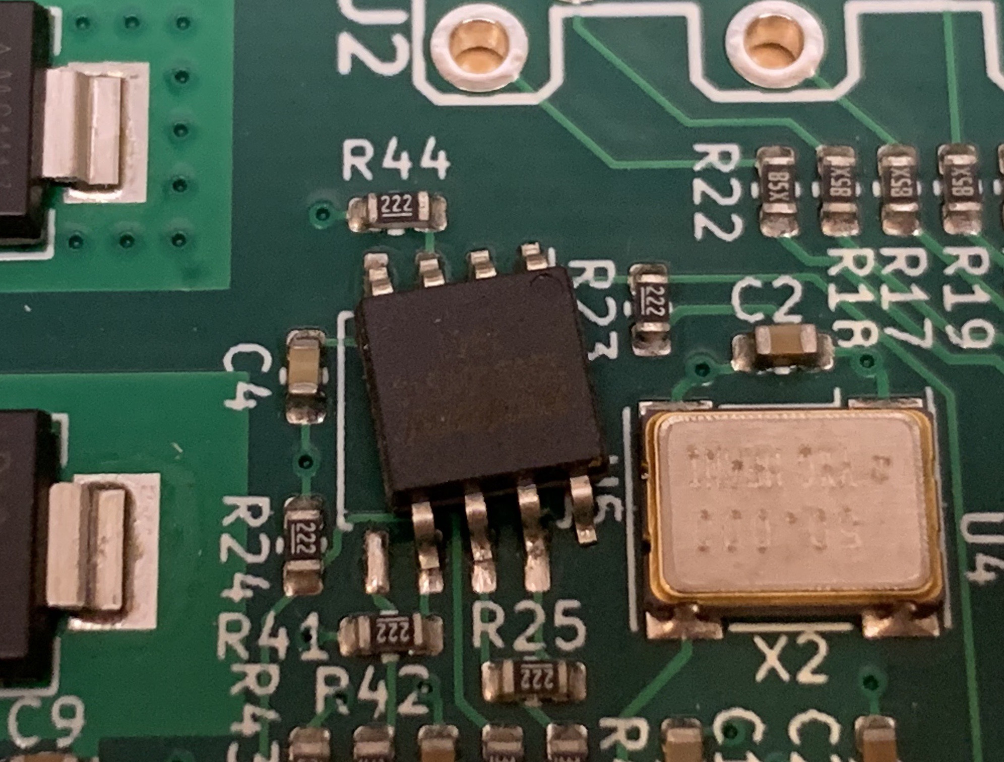

I left a comment, too ;) And, at least one chip they got almost right... it's the rightway round at least ;)
But hey, in the end the assembly fee for these boards was only like 22€ or something, that is nothing.
Posts: 2492
Re: QL-VGA v2
:D :D - that's only slightly wrong, at least 6 pins are soldered. Just in the wrong place.
