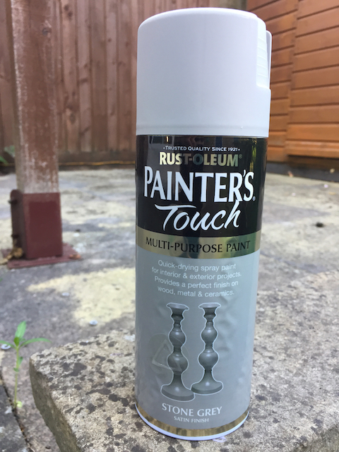

Retrobrighting can be blotchy even if you massage the Sun anti-tan lotion, it depends upon the plastic. My 520STM case just showed up the plastic flow lines as slightly more brown and it didn't matter how long it was processed for. I had to stop when the surface of the plastic started to pit. In the end I just sprayed it with this, which is a close match to the original colour:
