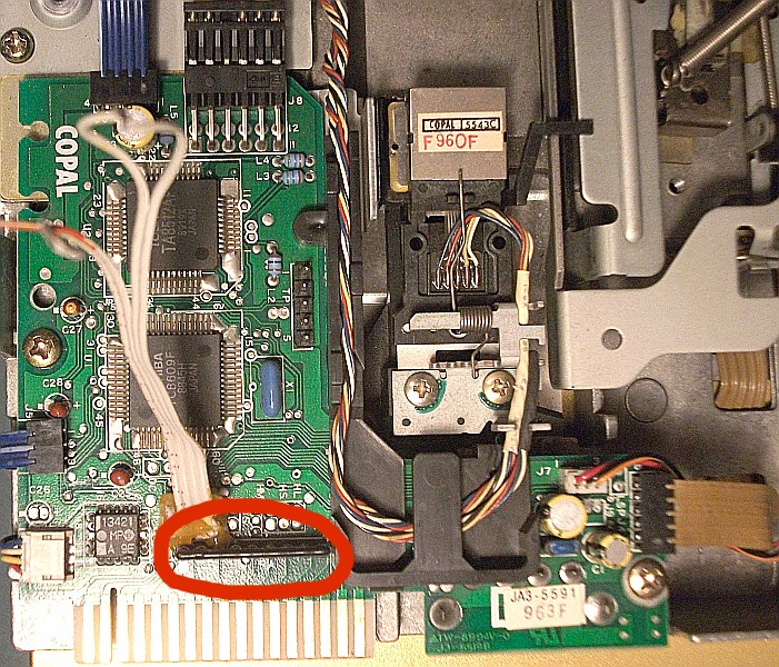

What is the situation with termination resistors on the drives? If they're terminated incorrectly, they may accept "motor on" signals but not recognize data properly. On 5/25" drives, usually only the data lines were terminated on the last drive, with a resistor pack.

Dave wrote:What is the situation with termination resistors on the drives?
I wish I knew :( I know they are important, but I don't have experience with this matter. Could you help me to locate the resistors in the picture I posted please? As I told, the drive is normally recognized and managed when connected to PC: do you have additional tests to suggest?

The Drive Select resistors, which are jimpers or wire links are labelled DS on the controller board. Which is where you have soldered some wires.

Derek_Stewart wrote: The Drive Select resistors, which are jimpers or wire links are labelled DS
Oh, but then the "termination resistors" are nothing but what I knew as the "drive select contacts/jumpers". Thank you for the clarification.
Yes, from the beginning I set the drive to DS1 and used a non-twisted flat cable. The drive is recognised as FLP2_.

Still, I don't know what should I do with these termination resistors...

Cristian wrote:Still, I don't know what should I do with these termination resistors...
Same as on SCSI.
Remove on the thru device, keep them in place on the last device.
(Excepting 3,5" drive).
http://www.minuszerodegrees.net/diskett ... nation.jpg
or
https://retrocmp.de/fdd/general/resistor-3.png
