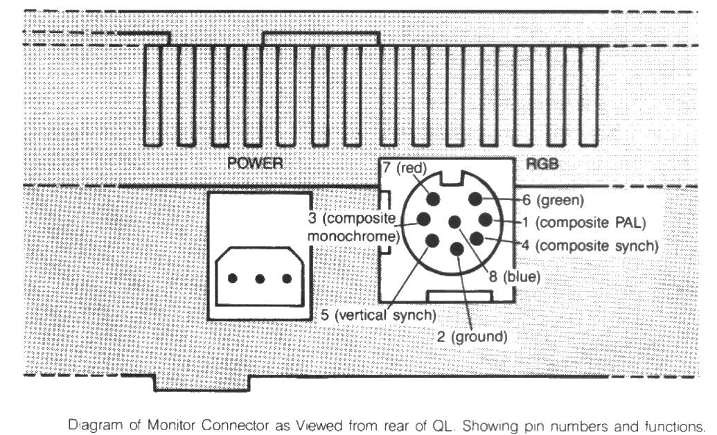

The connector for the QL (and maybe in general for this type of connector) has weird numbering. So you are 3 and 2 which should give composite monochrome.

When I use pin 9 of the MC1377 and ground off of the RGB connector (pin 2) I seem to get a color PAL composite signal (when using the composite connector on the TV, my TV seems to briefly display what type of composite input it gets) that basically looks pretty close (as crappy) to my RF signal -- this was the surprise as I expected composite to be better. But it is composite as it plugs into the yellow RCA jack on the monitor (not the RF coaxl)
