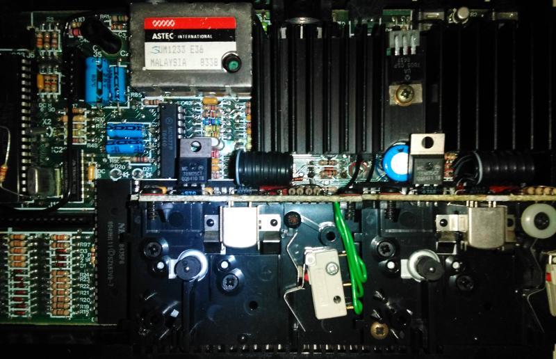

No circuit in the service manual. :roll: I have opened it and it looks weird. :? An SCR and two diodes stuck on windings opposite to the main PCB what is it all about. The caps are not blown or shorted. There seems to be 10.75V on each cap & between two pins on the power lead but the 44V AC is reading 16.7V. I will have to see where that comes from. :?

I checked the supply with a scope and on the output pins there is a 44V AC wave and 10.8V DC so could it be the 9V supply that is causing the problem? I would have thought the regulator for 5V could take a minimum of 12V input since many handle up to 35V. Having opened the supply and put it back together the QL still gives a green screen but this time holding the switch on the right it gives morse code like vertical lines every half inch across the screen. When the button is released there is a click as if something is being initialised so there has been a change compared to the first turn on but still the pale green screen that is slightly more stable and clear. It looks like I will have to open the QL up to make progress. :roll:

44V VPP measured with a scope is about 15.5V RMS - So, fine. Typically, voltages will go down a bit anyways under load.
The 10.8 Volts also look OK.

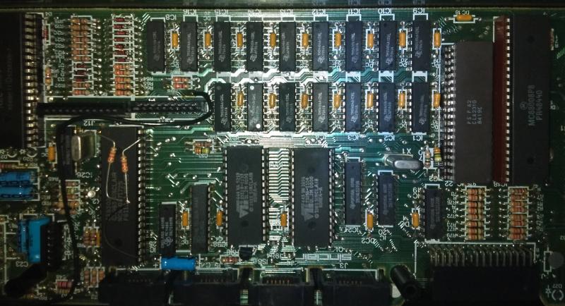

You really need to have a look inside. First thing to check is IC sockets - contact between sockets and ICs gets worse because of time and corrosion - simply remove and re-seat the socketed ICs.

tofro wrote:You really need to have a look inside. First thing to check is IC sockets - contact between sockets and ICs gets worse because of time and corrosion - simply remove and re-seat the socketed ICs.
It looks like it has just come out of the factory but I jiggled the chips about that sit in sockets and it made no difference. The 5V is on the regulator and the TTL chips. Since the RF video output is working and displaying the ram contents it is reasonable to assume its power is there and any power to the microdrives is irrelevant to booting I think but no sure. :? Any other suggestions as to where the fault might lie given the symptoms are welcome. A weird thing happened when I touched pins on the processor around pin 1 the system seemed to do the power on click but several times. It never did it again which is weird since if there was a sensitive signal one would expect it to always be sensitive and I thought it might be floating but still no difference to the pale green screen. :(
