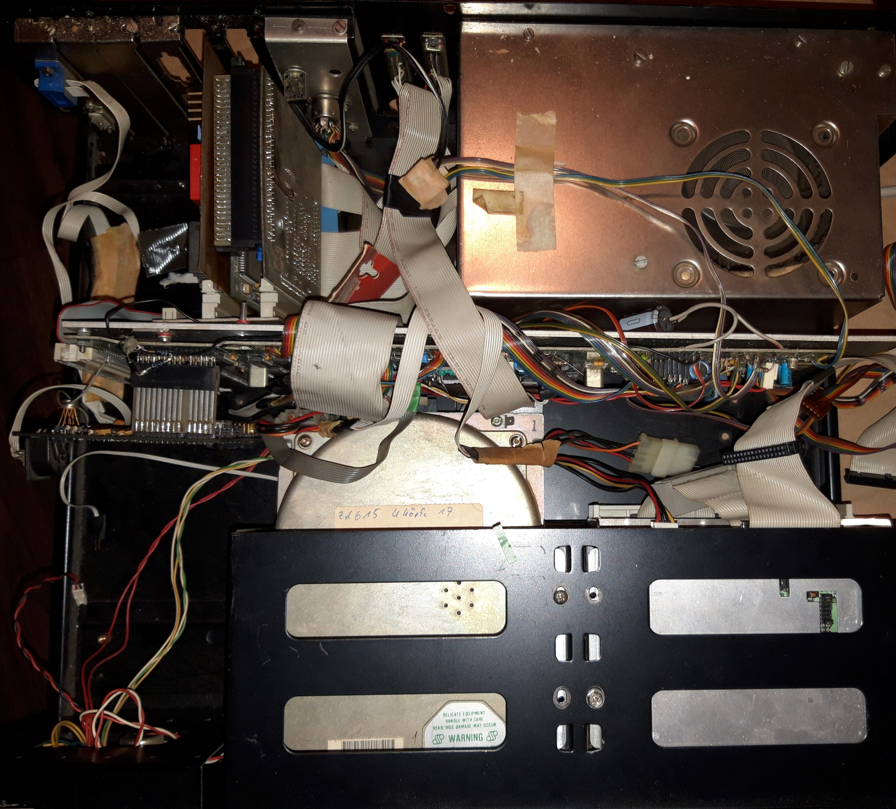

No, the GC doesn't work in the BBQL, instead now it flickers the screen a bit and then makes an awful fuzzy noise from the QL speaker. Then I noticed that the backplane is not entirely standard. What I thought was some sort of regulator to provide extra power to the backplane is actually a TIP112 transistor. The wiring is a bit messy and I'm not sure where that goes yet.
I did however put all the old case modded QL contraption back together and to my utter shock, it booted and tells me it has a HDD card and Gold Card. So that appears to be ok. I cannot get further for now as I don't have an AT keyboard to attach to it (and the original k/b connectors are well hidden). Here is a pic:

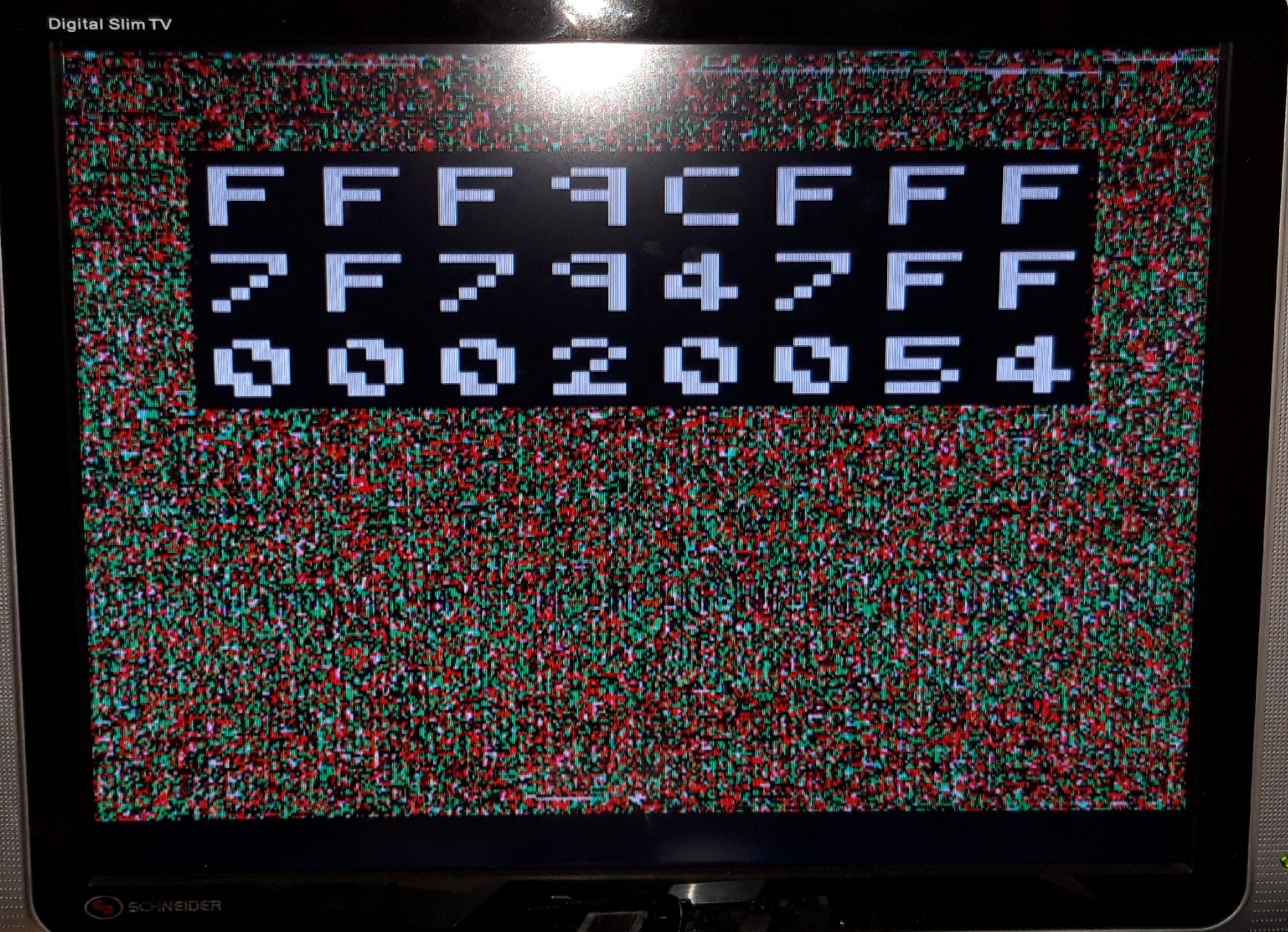

Back to the original BBQL - it doesn't seem right since I changed the ZX8301. It seems to take longer to react to the F1/F2 keypress and sometimes I get weird large numbers at boot, like this:

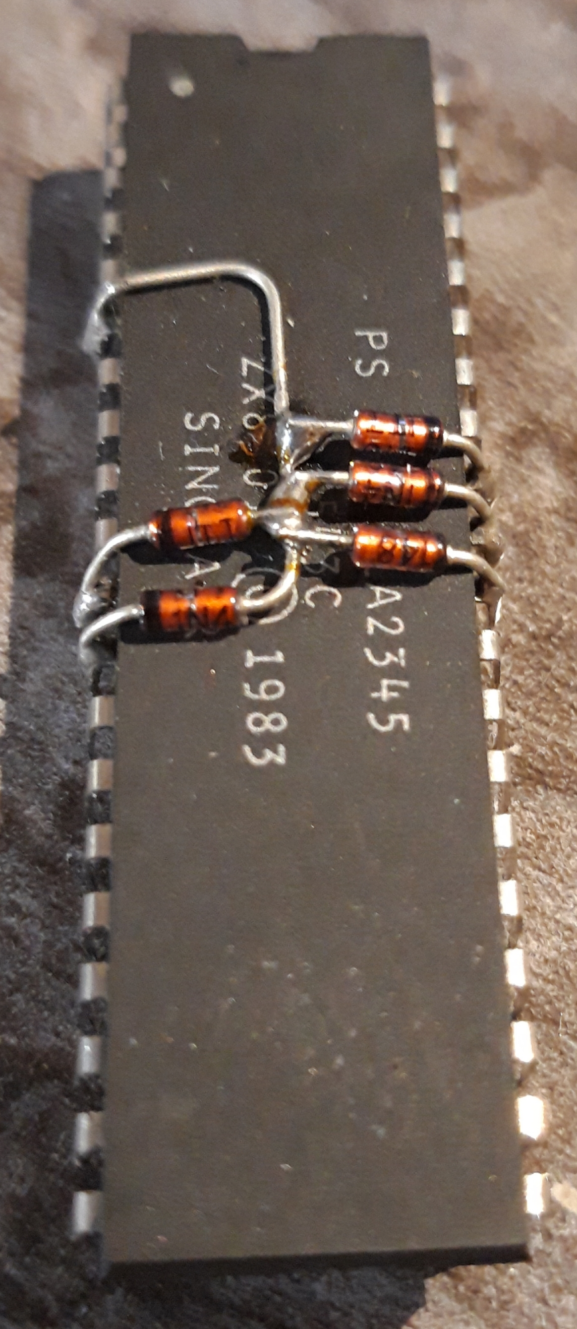

The ZX8301 in the donor wasn't actually labelled as a ZX8301 and didn't have this 5-diode mod like the original:
Could that be the cause of my new BBQL woes?

Smells like a RAM fault to me. See this helpful web page and the online decoder/calculator is here.
Could also be a dry solder joint, a poor connection (e.g. on an IC socket), or maybe a track that has a crack in the copper conductor. With all the disturbance, that may explain why it’s got worse and why it was not always showing up.

decoder output wrote:
Minerva (Sinclair QL) Faulty Ram Decoder v0.2
- MINERVA OUTPUT SCREEN -
WRITE: F F F 9 C F F F
READ: 7 F 7 9 4 7 F F
ADDRESS: 0 0 0 2 0 0 5 4
ADDRESS < 30000
BINARY STRING: 10001000
IC8 (BAD)
IC7 (GOOD)
IC6 (GOOD)
IC5 (GOOD)
IC4 (BAD)
IC3 (GOOD)
IC2 (GOOD)
IC1 (GOOD)
The Original Program (ram3_ramfail.bas) was written for the SINCLAIR QL in SUPER BASIC language by Dominic Brown (1990).
Converted in PHP language by Xad/Nightfall (8/5/2015).
And don’t worry about the diodes mounted on top of the 8301. They have been added to help to protect it from voltage spikes on the RGB video output port.
