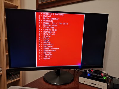

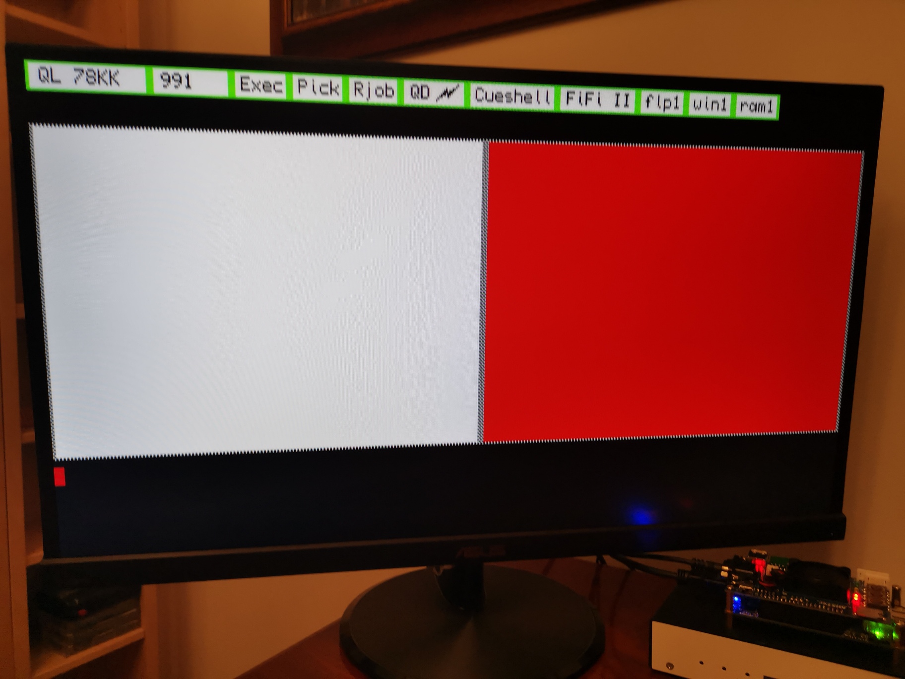

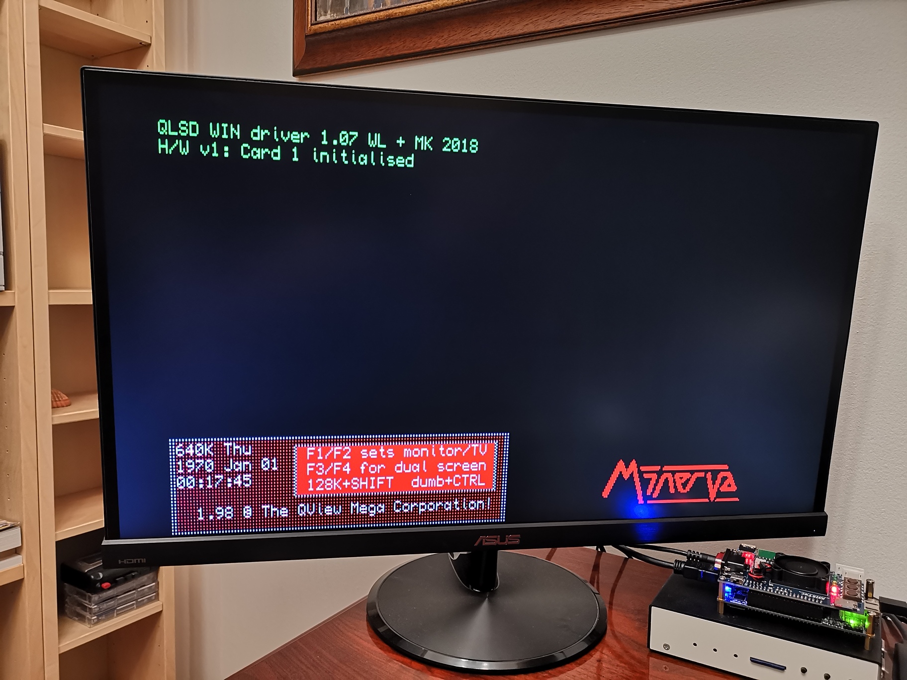

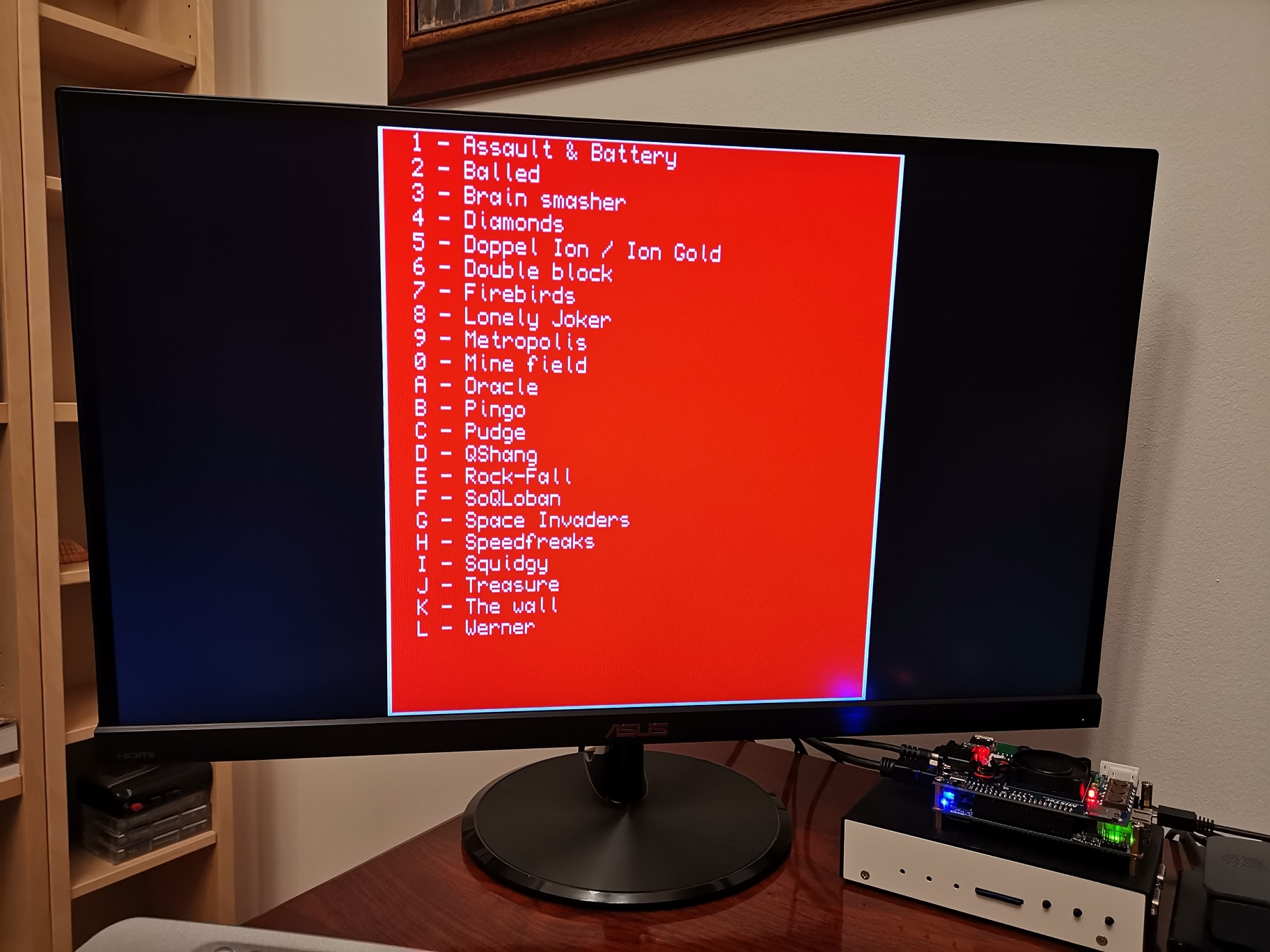

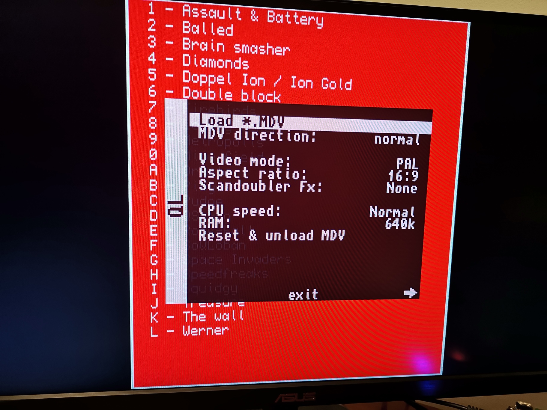

Tuna wrote:I've been experimenting with the MiSTer QL emulator built on the DE10 Nano FPGA board - it's a compact and fairly neat implementation of a bare bones QL - with some support for QL SD card images (though i can't get that part to work). It would be lovely if it got more support for disk images of various sorts, and even QL successors, but it appears there aren't that many people around to contribute to such a project.
I suspect you don't have I/O Card...
Without it (Mister I/O Card 5.5 XL) you miss the second SD reader where you should install qxl.win
So far everything work fine, Mister is about 2.5 faster than a bare QL. In the setup you should leave CPU to normal, if you try to use x2 or x4 doesn't work.
Try to attach some picture.
Fabrizio
