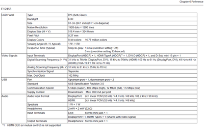

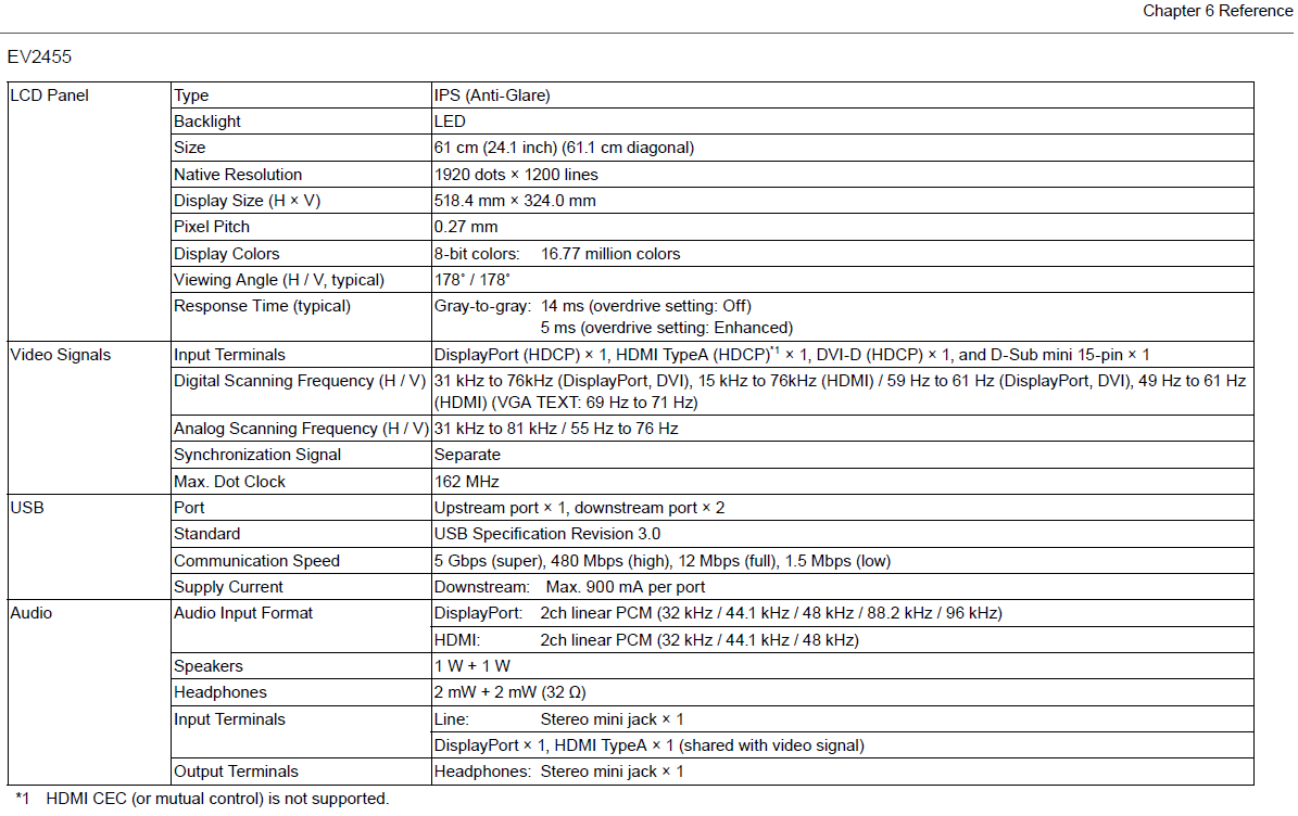

Aren't these the HDMI input rates ? Because yes, when the signal comes from the HDMI port, even modern monitors may go down to 24Hz (I suspect they double or triple the frame rate internally from their image buffer). However, for the VGA port (i.e. analog signals), the specifications might be different.
Here are the specs for my Eizo FlexScan EV2455 (which cannot do below 49Hz either via HDMI, if to believe those specs), a 2017 model which is not even of the cheap kind:

It would be great if we could get a list of known working (i.e. so far successfully tested) monitors for this 1024x768@50Hz mode, like I have been asking in my previous posts....
