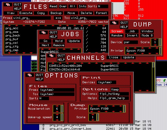

I put "QRAM" in quotes. QRAM was the precursor to the current Pointer Environment. It was QRAM that got me hooked on GUIs. Everything before that was just mickymouse, to my mind. Like Norm, I was a purist ;) (Ok, the original Apple Mac was cool, but getting behind the mask was a real pig and it cost a fist full of $$ just to try.)
So, back to your question: I dont know the status of the QRAM suit. I vaguely recall that at over time bits and bobs became increasingly incompatible with PI/Wman and SMSQ/E, and eventually stopped working. Everything that was salvageable ended up in the latest version of QPAC1. Of course, the original QRAM should still run on a BBQL.
Update: I just checked it out (latest QPC2/SMSQ): It seems to work again/still - ! At least somewhat. Doesnt do real directories, and I havent dared to use it, but there it is:

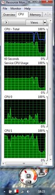

mk79 wrote:Have you enabled "Show kernel times" in task manager? How much of the CPU bar turns red if you do that?
Im not sure what you mean. This is W7.
But, is this any good?
[In Preview mode this image shows up twice :( I have no idea why. It may not do so in the final posting...]
This shows the last 50 secs of my activity in QPC2, fullscreen, Power Management = On. I moved a Files window around, after that it was just idling.
In Window Mode, things are slightly less hectic, as the next image shows. The bar top left in the QL part of the image, shows the level of my activity inside the emulator over the previous 60 secs. It almost looks as if idling costs more than actual activity!..
