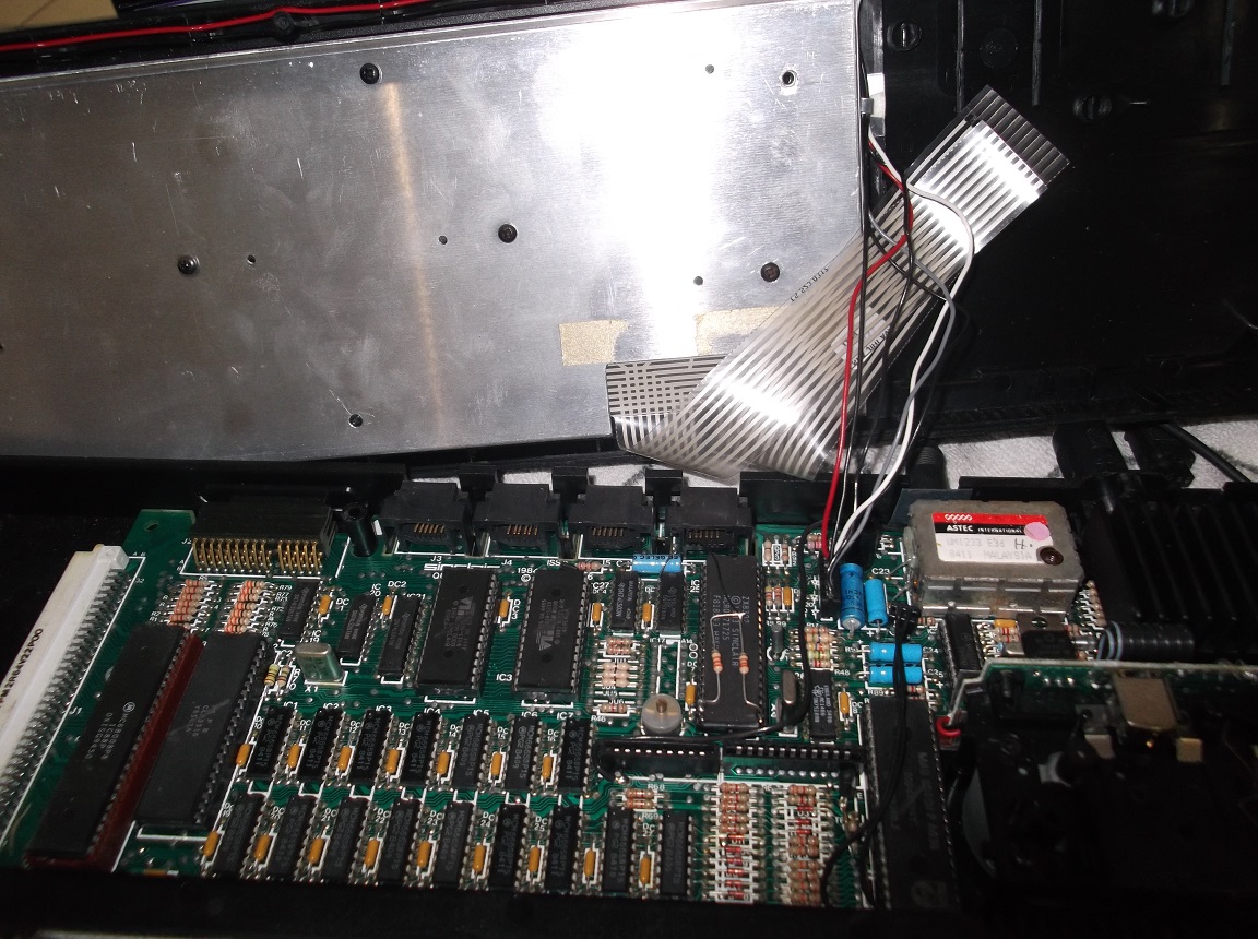

Please find a picture of the board. Please excuse the quality, I took it in a hurry. ;)

So that's one of the later Issue 5 boards - after the switch from 'piggy-back' EPROM to mask-ROMs.
You can see a space where another 74-series IC was used to help in the EPROM decode that then got consumed into the custom-masked ROMs themselves.
One thought:
The 15MHz crystal clock oscillator can become damaged as it sits proud of the board and can be fairly cheaply and easily purchased/re-soldered.
If that isn't toggling the clock, you might see the behaviour you have observed as it operates both the Master Chip (MC - 8301) and in turn, the CPU Clock. Its stood upright, horizontal, mid-way back on the board, just right of the MC itself and is a metallic silver can shape.
There's another similar oscillator running at 11MHz between the 8302 'Peripheral Chip' and the 8049 IPC. Possibly worth replacing that as well, as its pretty straightforward.
Don't worry about the smaller cylindrical can oscillator right next to the 8302 - that's a 32KHz that simply runs the 'real-time' clock (and 'tuned' by that variable capacitor with the small screw protruding from the top - something else they did away-with in later boards.)
Good luck!
