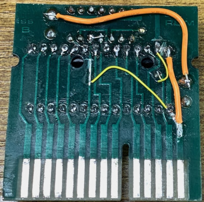

stephen_usher wrote: Sun Jun 08, 2025 3:07 pm Hack a ROM cartridge so that it passes all address lines through to the EEPROM and voila!
Hi Stephen,
Do you have an idiots (that's me) guide to this please?
Tony

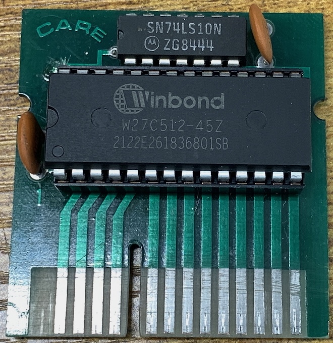

jobdone
Posts: 117
Re: Wondering if a "dead test" ROM is feasible on the QL.
Post by jobdone »
I think the easiest option is to use the pcb from here https://github.com/alvaroalea/QL_Rom_Cartridge . the full rom cartridge version.
Posts: 1200
jobdone wrote: Wed Aug 20, 2025 6:06 am I think the easiest option is to use the pcb from here https://github.com/alvaroalea/QL_Rom_Cartridge . the full rom cartridge version.
Thanks, I'd got the wrong end of the stick about what rom cartridge was being used

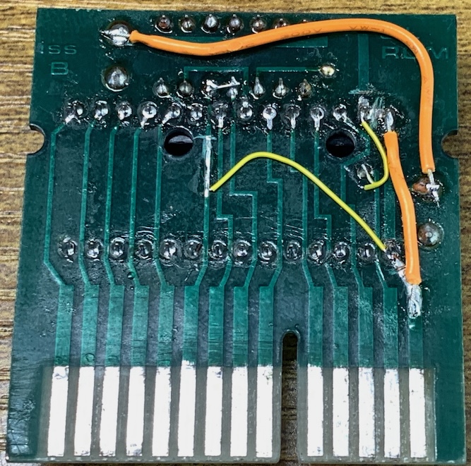

stephen_usher
Posts: 596
Location: Oxford, UK.
Post by stephen_usher »
Indeed, the new cartridge PCB is the best way.
I modified a cartridge I already had (which itself had been modified by someone else previously)...
Posts: 1200
Thanks Stephen
I have a spare one of those so I may give it a try
