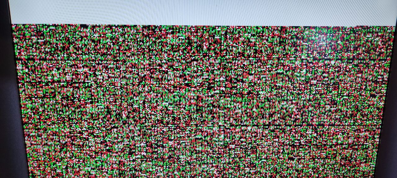

Recently, I recovered a QL. A few days later, it started crashing at startup, and now it doesn't work at all.
The symptoms are as follows: when I connect the power supply, the video pattern appears on the screen, but unfortunately, it never completes. At the end of the random pattern, a white strip appears at the top of the screen, while the rest of the display remains in a random pattern. And that’s it—no further response.
It doesn't respond to the reset button. Occasionally, it reaches the F1/F2 screen, but the keyboard doesn't register any input, and it still doesn’t respond to reset.
Before replacing any ICs, I’d like to confirm where the fault is. Unfortunately, I currently only have a multimeter and a 200kHz oscilloscope.
Does anyone have any suggestions or ideas?
Thanks in advance!
Thanks in advance!
