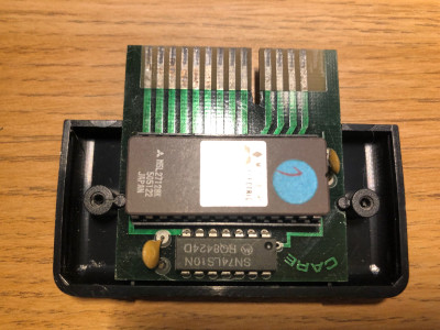

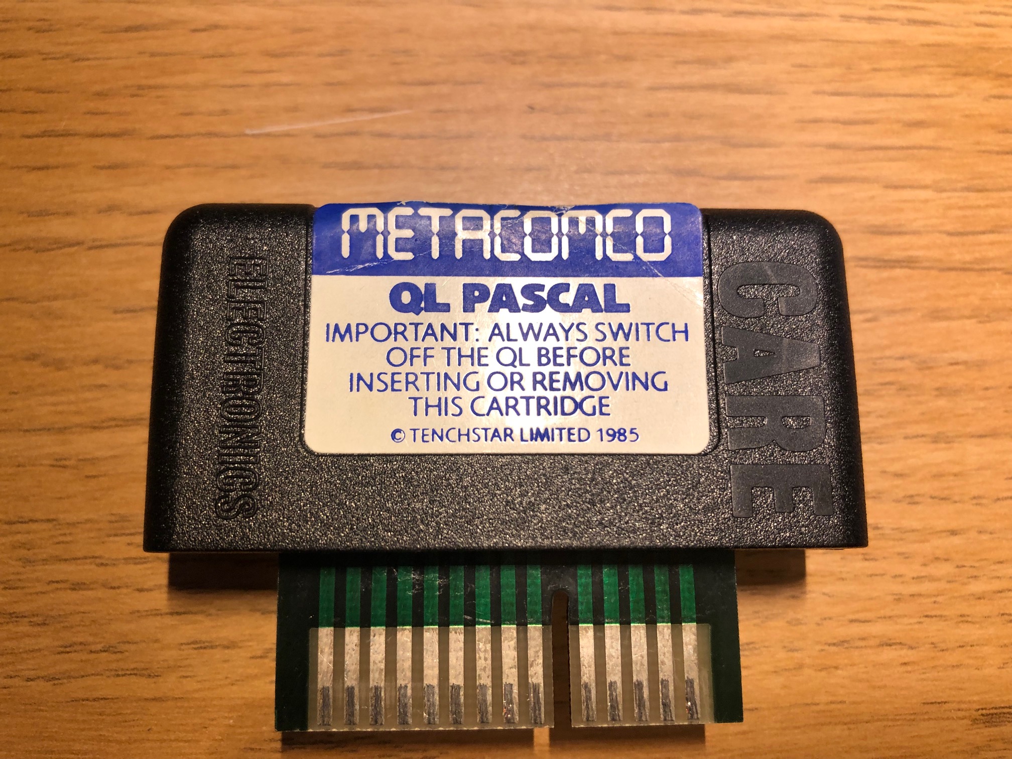

HI, I am a happy owner - well, used to be a happy one - of the QL Pascal Development Kit by Metacomco.
When I tested it a couple of years ago, the external ROM used to work fine. However, now upon running the Pascal programme the QL show the message "ROM not included or wrong version".
Is seems the external ROM is corrupt - is it possible to fix it?
I attach pictures should they show anyting particular.
Thanks!

The photo makes it look like the contacts are corroded.have you tried cleaning them with one of those cleaning brushes made, I believe, from fibregalss?
If I remember correctly, the contacts have a thin layer of solder over the copper, it dulls with age and resistance goes up as it oxidises. Maybe a rub down with IPA (Iso Propyl Alcohol) would also help?
Failing that, is the chip socketed? If so, the legs might need cleaning. Stab them onto a sheet of tin foil a few times.
HTH

In the dark depths of my hard drive I found something called PASCAL_ROM.zip. Looking at the unzipped file in an editor, it says QL Pascal v1.8. It's Metacomco, but don't know if it'll work with the software version you have.
Thought I'd post it here in case it becomes a matter of making a new EPROM. I'll assume it's OK to post it as it's for a repair and no use to anyone without the rest of the software and manuals.
Hopefully, Norman's suggestions will be sufficient, though.
EDIT: As an afterthought, do you have anything installed which might prevent access of the ROM port (only mention it as you said it's a couple of years since last use, in case you'd added anything in the meantime)
