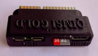

I have modified the QIMSI case, found on Thingiverse so that it nicely fits the QIMSI Gold version of the board. it can be found here https://www.printables.com/model/114540 ... -gold-case
Sorry about the 3D printed case shown in the pictures, I experimented with an option on my printer that seems to have shown all the seams in a random place.
Posts: 2489
Re: Announcing the new "Gold Card" - QIMSI Gold
Many thanks, interesting stuff! Could you also offer a variant without text?
