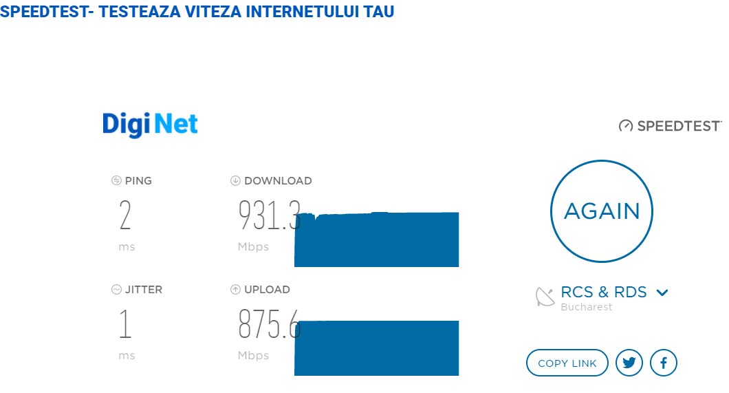

Today I received a new router. Well, for a 50E router and a 9E per month internet subscription, I guess it works pretty well.
