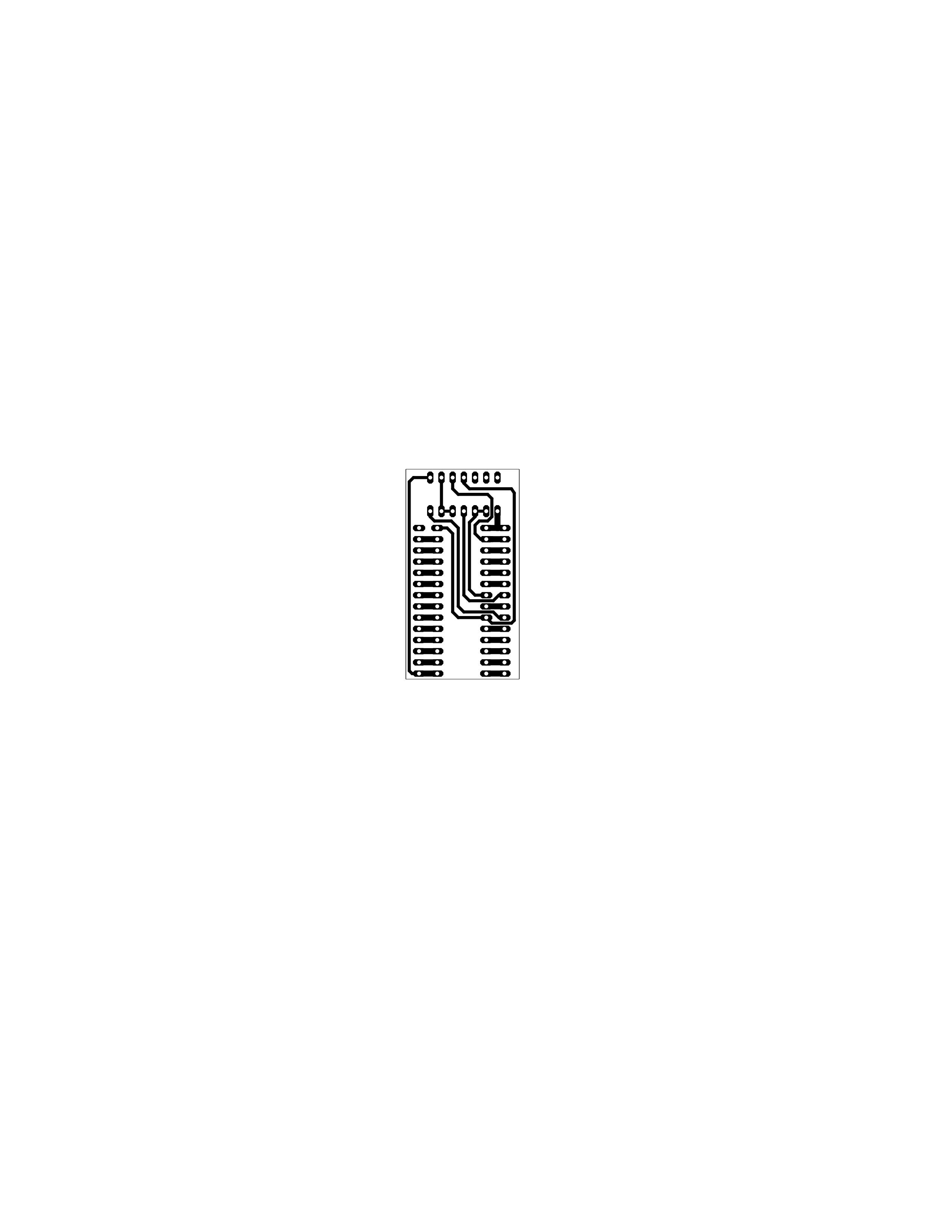

I have a similar problem with Chris. I made an EPROM with Minerva and TKII but on the boot screen wjile the Minerva logo is there I don't see the Qjump logo.
I checked on the EPROM programer and I do have the 4AFB at C000, the wiring of the pcb is correct but when I Type PRINT PEEK_W(49152) instead of getting 19195 I am getting 3855 (Hex F0F).
Any ideas will be greatly appreciated .
I was wondering in the pcb that is presented below if the part we see is the top or the bottom.
Thanks in advance Tassos
http://theqlforum.com/download/file.php?id=157&mode=view

That is the bottom. The left rank of pins is for the socket above (EPROM) and the right rank of pins is for the socket below (the QL).

Thanks Dave, no wonder why it is not working, I thought that was the top side so everything is reversed on the perf board.
I will make a new one and let everyone know how it will go.
Tassos
