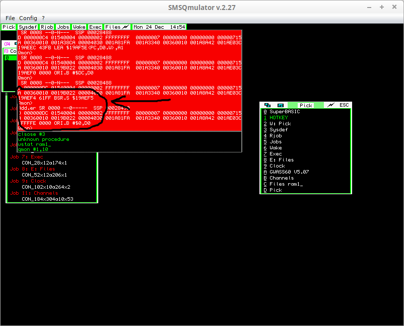

I'm not 100% certain whether the bug is in GWASS60_BIN or in SQLQmulator (Java 8 version running on Java 10).
Following on from my tale of woe at viewtopic.php?f=19&t=2656 I've attempted to assemble some code with my trusty GWASS60_bin (George Gwilt's GWASS for 68020 processors) version 5.07 (the latest version) on SMSQmulator version 2.27. I get an address errors as soon as I execute the assembler. The prompt to start assembling is green while the prompt to quit is white. QMON shows the following:
No matter how many times I run it, it always hits the same register dump with the PC set to $FFFFFE etc as shown in the screen dump. But that's probably not relevant. This has been used numerous times on QPC2 with no problems, hence my suspicion that it's SQLQmulator at fault.
I don't suppose anyone else is hitting this problem? I'm on Linux Mint 19.1 64 bit.
Posts: 2493
Re: SMSQmulator v2.27 bug, perhaps?
More information.
After a fresh reset of SMSQmulator, I ET gwass60_bin and the start address is $19A5FC. I've traced it through and the screenshot below, somewhere, shows that it barfs at an instruction at address $19AEF5 which is indeed an odd address. It got there from this code:
19AEF2 DIVS (A4),D4
19AEF4 BSR.S $19AEF5
Address $19AEF5 is half way through the currently executing instruction at $19AEF4!
This would tend to imply that faults is in GWASS, but it's been working for ages under QPC2, so I'm confused. (My normal state!)
Merry Christmas everyone.

Sorry, Norm, but this has to be a mistake of some sort. PROCESSOR returns 0 here, and nothing in the documentation suggests that SMSQmulator now implements a 68020. GWASS only works on a 20, AFAIK. 20s can operate with odd addresses which presumably is one reason why GWASS barfs under SMSQmulator.

MACHINE returns 20, PROCESSOR returns 0, at least under W$7.
But SMSQm8 is m68000 only so odd addressing should be avoided.
Gwass60 can and should be told to omit anything for 68020+. Read the manual.
