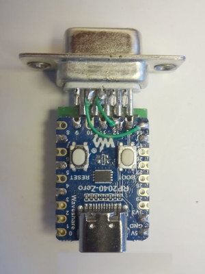

Peter wrote: Thu Feb 02, 2023 1:54 pm Also note that I did not add a cable relief in order to keep size as small as possible. So that needs to be covered by the HD-Sub case.
How does your prototype connect to a monitor being so short? Are you using a male or female DB-15 connector? I had looked to make one using the Pico, and was thinking of using a female DB-15 connector with a short cable, so I could then connect it to a normal VGA cable. I feared that some monitors have their VGA connector in a weird place (i.e. pointing down -- most of mind are awkwardly like that) and anything other than a standard VGA cable might be a bit hard to fit in to connect.
I thought it would be a nice compact design and then you create this awesome miniature version...makes me now want to wait to see if Derek makes a few :-) Of course it also depends on how the 5 volts is fed in since on my QL, pin 1 is already set for that.
Edit: you never actually see the connector on the github page and for whatever reason I thought it was male...but looking at it more closely I think it's actually female, so never mind...[slaps forehead]

bwinkel67 wrote: Sat Feb 04, 2023 10:21 pm How does your prototype connect to a monitor being so short? Are you using a male or female DB-15 connector?
I used a female HD-Sub, so I can use the normal VGA lead.

Derek_Stewart wrote: Sun Feb 05, 2023 9:33 am Due the change of the HSYNC & VSYNC to GP12 & GP14, require changes to the schematic and layout?
Not really, I just updated the comments in the schematics, attached.
If you read even the old schematics and look at the pictures, you see that the PCB only connects to pins 1 to 10 of the HD-Sub!
Consequently, HSYNC & VSYNC must be directly wired from the RP2040-Zero module to Pins 13 and 14 of the HD-Sub.
The recent change just makes that easier, so you have decent throughhole pads to connect, and do not need to desolder the LED.
Think of this: A HD-Sub has three rows of pins / solder buckets! How would you directly connect a PCB to that, if you want to fit a D-Sub case?

Your earlier photographs show the Mini VGA board soldered to VGA pins 1-5, whivh should support the VGA and Pico RP2040-Zero.
A wire link from GND to VGA pins 6,7,8 and wite links to HYSNC, VSYNC. Pity VGA pin 5 was not connected to GND, so that a common connection to 5,6,7,8, would save wire link.

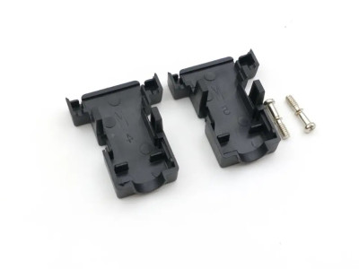

I thought the converter could be fitted into this type of D-Sub case:
D-Sub shell
D-Sub shell
The adapter could be powered by the RP2040-Zero USB connector from the monitor or other USB Power supply.
