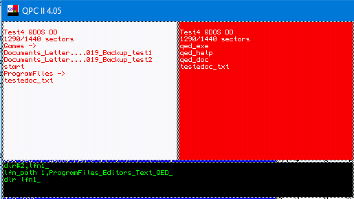

I have been playing around with a directory device driver that supports long file names (up to 72 characters). By adding a path to the start of any file name provided by the operating system. On a per job basis.
So each job could have a LFN1_ device pointing at a different directory on the same storage medium.
This is just a proof of concept, So don't expect everything to work...
This is a screen shot showing DIR with and without the added path

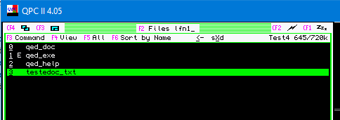

I even got QPAC2 to recognize it

Not sure if I tried WDIR or WCOPY. If you use WSTAT, it gets a little upset if it encounters a long file name that has been chopped down to 36 characters with the '....' in the middle.RWAP wrote:Excellent - there was the sub device driver also, but from memory it failed on WDIR or WCOPY....
Rich
The file size is displayed as 'not found', but carries on regardless. I don't quite know why WSTAT tries to open each file to get the file size and update date, when these can be obtained from the directory which it had to access anyway. Unless it's some sort of hang over from Microdrives.
